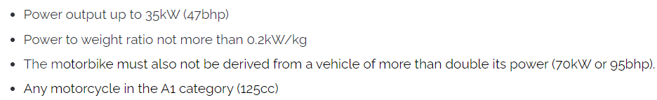

Siin on nõks teine jutt. Ehk siis viites direktiivile pole sõnu "või" seega kõik tingimused peavad olema täidetud.
https://www.transpordiamet.ee/soidukite ... mootorratt
Viites olev tekst:
3. motorcycles with or without a sidecar and motor tricycles:
— ‘motorcycle’ means two-wheel vehicles with or without a
sidecar, as defined in Article 1(2)(b) of Directive
2002/24/EC,
— ‘motor tricycle’ means vehicles with three symmetrically
arranged wheels, as defined in Article 1(2)(c) of Directive
2002/24/EC;
(a) Category A1:
— motorcycles with a cylinder capacity not exceeding 125
cubic centimetres, of a power not exceeding 11 kW and
with a power/weight ratio not exceeding 0,1 kW/kg,
— motor tricycles with a power not exceeding 15 kW,
— the minimum age for category A1 is fixed at 16 years;
(b) Category A2:
— motorcycles of a power not exceeding 35 kW and with
a power/weight ratio not exceeding 0,2 kW/kg and not
derived from a vehicle of more than double its power,
— the minimum age for category A2 is fixed at 18 years;
(c) Category A:
(i) motorcycles
— The minimum age for category A is fixed at
20 years. However, access to the driving of motor-
cycles of this category shall be subject to a
minimum of two years' experience on motorcycles
under an A2 licence. This requirement as to previous
experience may be waived if the candidate is at least
24 years old.
(ii) motor tricycles with a power exceeding 15 kW
— The minimum age for motor tricycles exceeding 15
kW is fixed at 21 years.

Turist...kui lähtuda loogikast siis peaks see valem pigem kasutama tühimassi väärtust, mitte sõiduki registri/täismassi. 100% õige ei ole loomulikult kumbki.
Loomulikult kuskil ei mõõdete seda niinimet "tegelikku massi" aga ega registrimass pole ka ju samas praktiliselt mitte ühelgi juhul see tegelik mass, millega sa ringi sõidad. Isegi mitte sinnapoole. Võibolla ühekohaliste ja ühekohalisena regatud tsiklite puhul veel kuidagi sinnakanti aga enamus rattaid siiski ilmselt kahekohalised ning registrimass vist tavaliselt võetakse tootjapoolsest täismassist üks ühele. Tootjapoolne täismass aga tähendab absoluutset maksimaalset koormat, kuni milleni aparaat veel vastu peab. Ehk ratas ise + kahte sõitjat + varustust. Kuidas sul muidu see 390kg tulla saaks, 200kg sellest on ilmselt arvestatud "koormaks" ning ülejäänud on mahlade ja vedelikuga tsikkel.
Aga mida ARK selle massi all täpselt silmas peab, pole aimugi...üsna kindel, et mitte loogilisemat varianti
seega jah, tõenäoliselt küll käib jutt registrimassist

See on arvel ja ei ole ümber ehitatud. Tühimass 202 kg, registrimass 390 kg.
- Postitusi: 1455
- Tänanud: 291 korda
- Tänatud: 233 korda
See “ja” ning “või” seal seaduses on miljon korda poe taga vaidlemiseks alust andnud.
Tegelikkus on see, et mõeldud on tõepoolest, et täidetud peavad olema kõik tingimused.
Ja kui seda arvesse võtta, siis muutub see kaal ebaoluliseks, sest näiteks mõni vana matkapomm, millel on 37kw ja 232kg, siiski EI OLE mõeldud sõitmiseks noorematele kui 21-aastased.
Minu arvates on see üks äärmiselt ebaõnnestunud seaduse sõnastus. Aga ma saan aru, et nii seda mõistetakse…
Seaduseandja võiks selle sõnastuse korda teha…

Suhedlud korra varem sellel teemal maanteeamtiga ning jah .... muidugi .... võetud on kõige ebaloogilisem ehk siis registrimass.
- Postitusi: 84
- Liitunud: 08 Veebr 2019, 11:48
- Tsikkel: BMW 1200GS Adventure
- Tänanud: 5 korda
- Tänatud: 12 korda
Mis on mõeldud pole oluline, hetkel Eestis kehtiva Liiklusseaduse järgi peab olema täidetud üks kahest tingimustest. Erivõimsus alla 0,2 kw/kg või alla 35kw.
Imelik on muidugi see, et Transpordiameti koduleht viitab Euroopa Liidu direktiivile kuigi vaidluse puhul lahendatakse case siiski LS-i põhjal.
https://www.riigiteataja.ee/kohtulahend ... =254564185
Aga jah, võiks korda teha küll selle pardakki.

Minu tsiklil on kw/kg suhe passis kirjas ja see on võetud tühimassi järgi, seega kui on 37kw ja 202kg/tühimass, siis eesti seaduste järgi peaks A2 alla käima, sest üks tingimus on täidetud(0,18kw/kg)

Kui keeruline saab see ja ning või olla?morse kirjutas: ↑13 Veebr 2022, 16:42See “ja” ning “või” seal seaduses on miljon korda poe taga vaidlemiseks alust andnud.
Näide:
Kohtusse peavad ilmuma Ants ja Jürka. -mõlemad peavad ilmuma.
Kohtusse peab ilmuma Ants või Jürka.. - üks neist peab ilmuma..
ja kui vaadata seda sõnastust seaduses siis kasutatakse mõlemat :
A2 – mootorratas, mille mootori võimsus ei ületa 35 kilovatti või mille võimsuse ja massi suhe ei ületa 0,2 kilovatti kilogrammi kohta ning mis ei ole ümber ehitatud sõidukist, mille võimsus on vähemalt kaks korda nii suur
A1 – mootorratas, mille mootori töömaht ei ületa 125 kuupsentimeetrit ja võimsus ei ületa 11 kilovatti või mille võimsuse ja massi suhe ei ületa 0,1 kilovatti kilogrammi kohta.
Täis- või tühimassi teema ei ole ARKi otsustada, see A2 kategooria definitsioon on üle-Euroopaline. Kui Eesti hakkaks mingeid oma reegleid leiutama, siis ei viitsiks ükski tehas spetsiaalset "Eesti-A2" versiooni toota ning tüübikinnitada, et heal juhul 20-30 tsiklit aastas rohkem müüa. Kogu probleem on selles, et ARK ei tunne tähti, direktiivis on ühemõtteliselt kirjas, et mõlemad peavad täidetud olema.

@Ain see on nii keeruline, et inimesed käivad seda kohtus lahendamas. Kusjuures kohtulahend on selline, mis toetab eestikeelset seaduse sõnastust (millest ametnikud üldjuhul teisiti aru on saanud) aga ei toeta ingliskeelse direktiivi sõnastust absoluutselt. Ju ikka on halvasti mõistetav seadus…
Kopeerin ülevalt näited võrdlemiseks kokku:
I Direktiivi tekst, millel asi põhinema peaks:
b) Category A2:
— motorcycles of a power not exceeding 35 kW and with a power/weight ratio not exceeding 0,2 kW/kg and not derived from a vehicle of more than double its power,
II Meie seaduse tekst:
III Kohtulahend:
Kohtuväline menetleja leidis otsuses, et I.D kui A2 kategooria juhtimisõigusega isik
ei tohi mootorsõidukit Kawasaki Z550GT juhtida, kuna selle võimsuseks 41 kW ja A2
kategooria juhtimisõigusega isik tohib juhtida ainult kuni 35 kW võimsusega mootorsõidukit.
I.D hinnangul on selline seisukoht väär. Vastavalt LS §-le 93 tohib A2 kategooria
juhtimisõigusega isik juhtida mootorratast, mille mootori võimsus ei ületa 35 kW või mille
võimsuse ja massi suhe ei ületa 0,2 kW/kg. Kawasaki Z550GT on küll 41 kW, kuid jääb oma
erivõimsusega, mis on 0,178 kW/kg, alla lubatud piiri.
Kohtu seisukoht
Mootorratta Kawasaki Z550GT dokumentide kohaselt on tegu mootorrattaga, mille võimsuse
ja massi suhe, st erivõimsus on 0,178 kW/kg (tl 4). Seega on tegu A2 alamkategooria
mootorsõidukiga LS § 93 lg 3 p 2 järgi, sest nimetatud punkt sätestab, et mootorratas, mille
mootori võimsus ei ületa 35 kW või mille võimsuse ja massi suhe ei ületa 0,2 kW/kg ning mis
ei ole ümber ehitatud sõidukist, mille võimsus on vähemalt kaks korda nii suur, kuulub A2
kategooria mootorsõidukite hulka. Kuna I.D-le on välja antud juhiluba AM, A1, A2, B1 ja B kategooria mootorsõidukite
juhtimiseks (vt tl 3), siis ei saa väita, et tal puudus mootorratta Kawasaki Z550GT juhtimiseks
õigus. Järelikult ei ole I.D LS-i nõudeid rikkunud ega LS § 201 lg 1 järgi
kvalifitseeritavat väärtegu toime pannud. PPA Lõuna Prefektuuri 22.04.2019. a kiirmenetluse
4
otsus väärteoasjas nr 2780,19,004670 kuulub kõnealuse teo I.D-le inkrimineerimise

@urmas66 sinu välja toodud punktides ei ole eeldust, et piisab, kui ratas vastab ainult ühele punktile. Muidu ei oleks ju ka toodud näitena seda, et ümberehituse saab teha maksimaalselt 70kw-sest rattast.
Need viidatud punktid toetavad seda (konservatiivsemat) vaatenurka, kus A2 ratta puhul peavad täidetud olema korraga nii max erivõimsuse kui max võimsuse näitajad.
Eesti seaduses on minu arvates tõlkeviga ja seda tõlkeviga ei parandatud ka viimase seaduse muudatusega.
Edit: paar lambikat näidet Euroopa ingliskeelsetelt saiditelt:
1. Mingi Soome autokool:
A2-LICENSE allow you to drive a light motorcycle of which the maximum engine power is 35 kW and power/vehicle weight ratio does not exceed 0,2 kW/kg.
https://www.lahdenseudunautokoulu.fi/en/a-licenses/
2. Sait, mis selgitab Saksas mootorratta lubade saamise korda:
A2 Motorcycles (including side-cars) with an engine power of not more than 35 kW, where the power to weight ratio does not exceed 0,2 kW / kg.
https://routetogermany.com/drivinginger ... classes#A2
